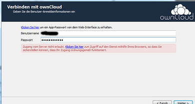

But no client works. I installed the Desktop-Client (Windows) but i can not login via this client.
So i also tested to create a app-password as well. It also works not.

Which client version is that?
Anything useful in the server log files? owncloud.log and HTTP access.log and error.log?
