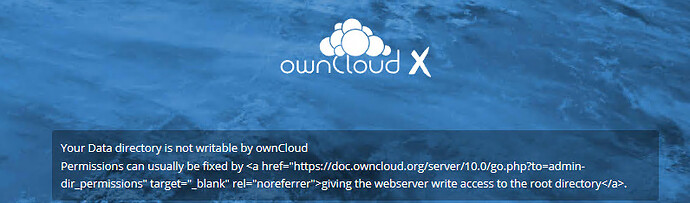

When i am changing ownlcoud data folder from /root to /home via config File it is giving an error on web link
“Data directory is not writable by Owncloud”
I have given apache owner to that folder but the issue remains
i have also created a symbolic link for data folder but then too issue not solved
Is there anything that i am missing?

This error is coming when i am changing Data directory path in config.php file
as per the links i have created a symbolic link between /var/www/html/owncloud/data to /home/owncloud, but after changing the data path in config this error comes
My concern is to make /home/owncloud/data directory usable rather then /var/www/html/owncloud/data
But you still give no info about the current situation. Ownership and permissions of the two directories in question. Nobody can help here.:roll_eyes:
I have installed owncloud 10 in centos 6.7 installation path is /var/www/html/owncloud, this is having apache user and group ownership and 775 as permissions
owncloud is getting accessible via browser successfully and the database type is mysql
but as /var/www/html/owncloud is located in root mount which is of max 50 GB i need to change data directory to /home
Now i have created a symlink from old path to /home path and also changed data path in config and mysql (via phpMyAdmin)
httpd service restarted
now when i access owncloud on browser i am getting
your data directory is not writable by owncloud

even after canceling the symlink and changing path in db and config the issue remains same
ls -la /home/owncloud | head -n 2
IIRC, http user for centos is apache. So why do you expect it should be allowed into roots directory?
Should i change owner of home to apache?
Not of /home (!), but /home/owncloud and everything below.
done for /home/owncloud whole directory
httpd servive restarted
but then too its showing that data directory is not writable
grep datadirectory /var/www/html/owncloud/config/config.php | sed “s/[',]//g” | cut -d’ ’ -f5 | xargs ls -la | head -n 2
