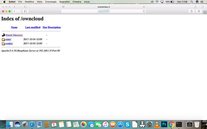

I changed the line quoted by you, now when I try to connect to http: //192…/owncloud i have this screen:
if I try to open the page with https: // 192 … I get the message “Safari can not connect to the server”

it is called raspberrypi, I tried both http: // raspberrypi / owncloud and https: // … with the first I got the index schrmata, with the second telling me that safari can not connect to the server
