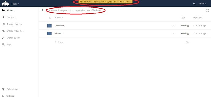

I have installed in our hosting server; but am not able to upload the files to shared folder, whenever i try to upload files show error " You don’t have permission to upload or create files here ownCloud Files" In own Cloud 9.0 Version
The person, which shared the folder with you did not enable option “enable upload to folder” in the folder’s sharing tab. If that is not the case, we will go further with the issue :slight_smile:

Thank you for your response; in admin User only am trying to upload; i here by enclosed screenshot

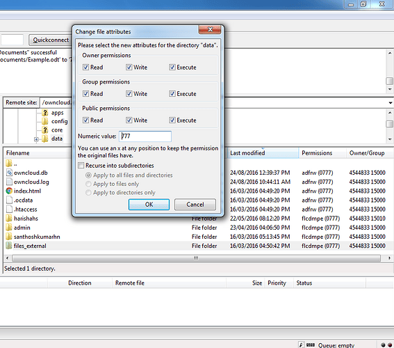

I got the data path from config file and I set all read,write, execute permission to data folder using ftp filezilla; but still facing same permission error ; file permission details enclosed.
The problem migth not only be the read/write permissions, but also ownership of the file (chown). You also need to give this rigths recursively to all the subdirectories and files.
