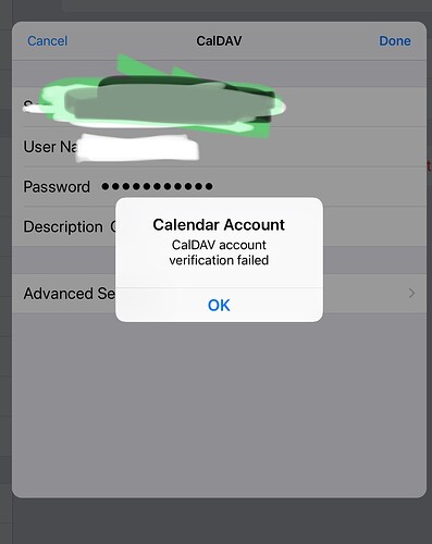

iOS 12 calendar iOS stock via caldav
iOS calendar was syncing fine on 11.4.1
Now that 12 is out it wont connect anymore
Using latest stable OC
iOS 12
Nothing in ownCloud.log

I too have the problem after iOS upgrade to 12.0.1 with oC 10.0.10 with http:// access.
The CalDav works fine with Thunderbird the only problem appears to be with iOS devices and verifying the account login.
Hope there is a fix/patch soon not being able to sync calendars among our iOS devices is pretty frustrating.
