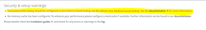

Now I am getting the below warnings once log in to owncloud. We are about 10 users and I am not familiar with this. Do I need to install it? I am using Ubuntu 16.04 Ubuntu server. Thanks for the help!!!
