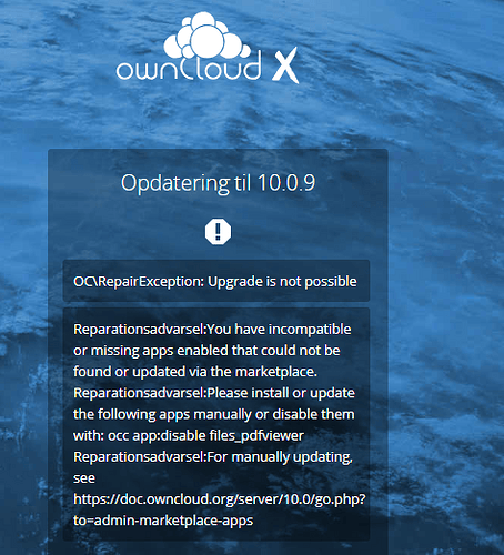

I guess I made a mistake. I have 10.0.85 installed as a package from my server and now I manually tried to upgrade to 10.0.9… OwnCloud turned into maintenance mode, which I have disabled. This way I got a message “Click to upgrade” and than this:
OC\RepairException: Upgrade is not possible
Repair warning: You have incompatible or missing apps enabled that could not be found or updated via the marketplace.
Repair warning: Please install or update the following apps manually or disable them wit…

Tried to update my OC installation this morning and it seems every app I ever installed is incompatible with the latest version. Could I ask how I would go about disabling or uninstalling these so I can get my install working again?
This is the part I don’t understand:
disable them with: occ app:disable afterlogic occ app:disable audioplayer occ app:disable calendar occ app:disable contacts occ app:disable files_clipboard occ app:disable files_pdfviewer occ app:disable fi…
